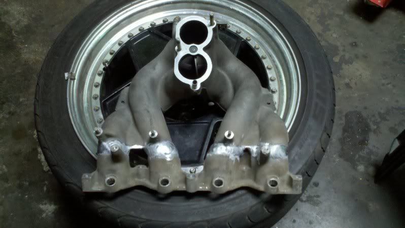

Engine bracket cut to cater for 10 degree difference between engine and m20 box. Shortening of the manifold cause mech scare it will hit brake master pump when its running. I don't really agree with their way of doing things though but so far their workmanship looks good enough for me.

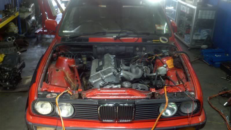

Korek korek korek guys. Here some updates, hopefully can go puspakom by this week:
Shortened intake manifold

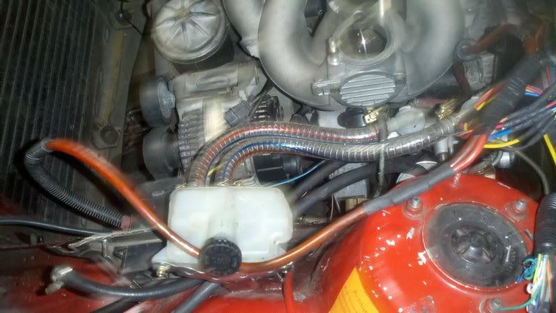

Vanette remote reservoir.

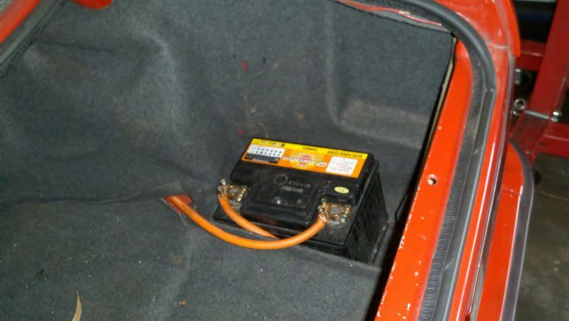

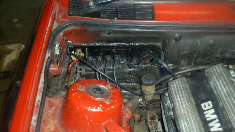

Coil pack will be installed at battery tray. Battery moved to boot.
Wiring in progress.

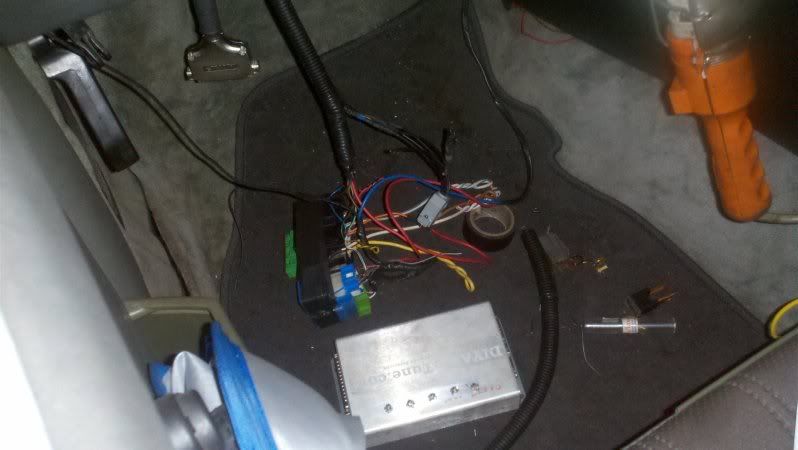

Here's some pics from today. Tested cranking the engine today and its giving out spark and injector are firing too Smile
Battery relocated to boot.
Fresh new harness.

2. Relocate battery to boot.

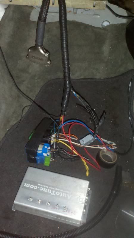

3. Megasquirt standalone ecu.
4. New harness for megasquirt.
5. Dual layer nissan servo with remote reservoir.

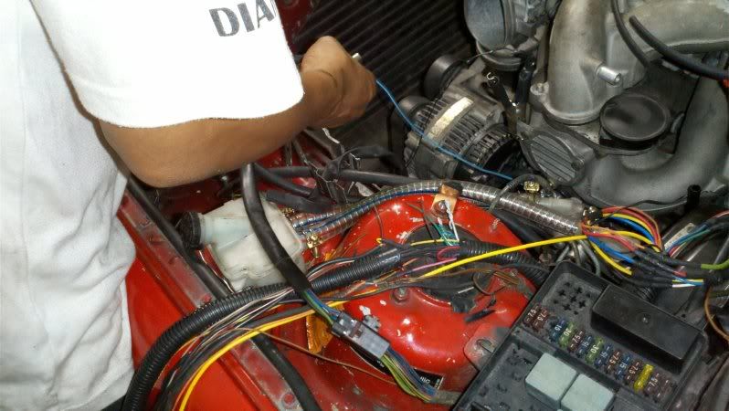

Why don't your mech try to build the harness from scratch? My mech did. For ecu pinout and electrical diagram you can refer to e36 bentley manual. I have the softcopy if you need it. Let me know if you need any bits from the wiring loom as I have plenty lying around.
