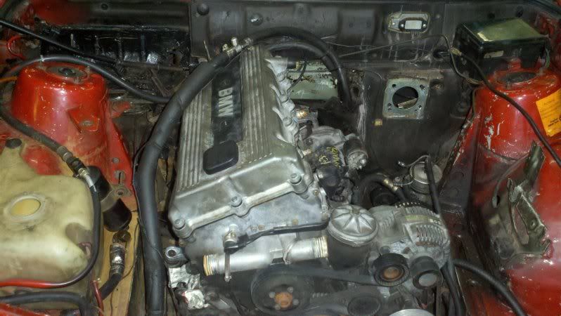

I told the mech that but he want to go ahead with engine mounting since mounting bracket sudah potong oredi. He'll modify steering column to cater for the exhaust. Should be ok i guess as he will modify only one bracket. The tilt looks better today:

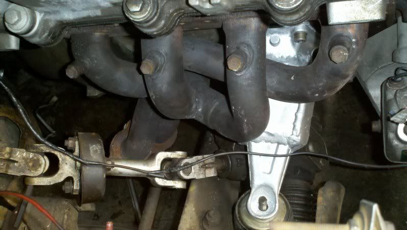

PostPosted: Mon Feb 14, 2011 11:11 am    Post subject: Re: M20B20 to M42B18 swap Reply with quote
Good news: can use back m42 e36 rhd header. E30 m42 header shown.

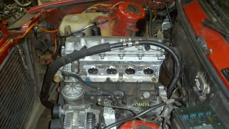

Bad news: need to shorten intake manifold to clear brake servo.
PostPosted: Wed Feb 16, 2011 11:33 am    Post subject: Re: M20B20 to M42B18 swap Reply with quote
Intake manifold shorten and reverting back to e30 header due to clearance issue. Now waiting for longshaft to be modified as its too short for m42.

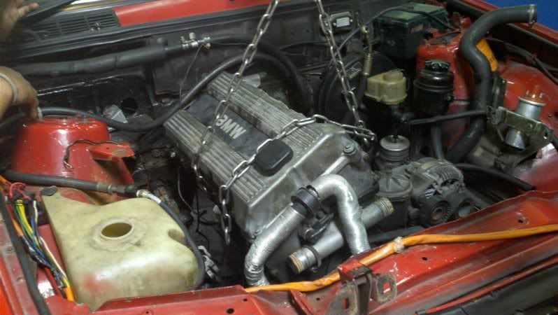

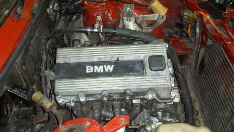

PostPosted: Thu Feb 17, 2011 10:34 am    Post subject: Re: M20B20 to M42B18 swap Reply with quote
Some pics for today:

PostPosted: Thu Feb 17, 2011 11:55 am    Post subject: Re: M20B20 to M42B18 swap Reply with quote
can you reason why did you re-tilt your engine angle and cut the engine bracket on the right with the shortening of the manifold ?

PostPosted: Fri Feb 18, 2011 12:48 pm    Post subject: Re: M20B20 to M42B18 swap Reply with quote
Engine bracket cut to cater for 10 degree difference between engine and m20 box. Shortening of the manifold cause mech scare it will hit brake master pump when its running. I don't really agree with their way of doing things though but so far their workmanship looks good enough for me.

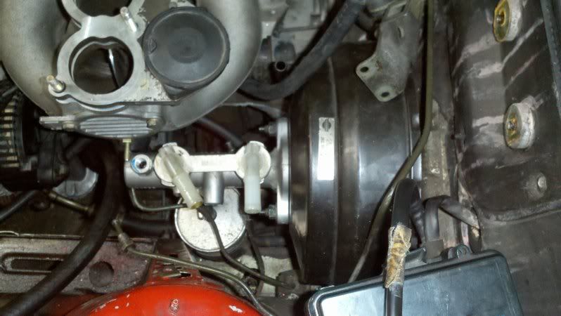

PostPosted: Fri Feb 18, 2011 1:07 pm    Post subject: Re: M20B20 to M42B18 swap Reply with quote
Frankestein upgrade, unknown nissan servo mix with nissan vanette master pump with remote reservoir. Look at how close is the clearance.

PostPosted: Sat Feb 19, 2011 2:23 pm    Post subject: Re: M20B20 to M42B18 swap Reply with quote
kura2 wrote:
okay, since you tilt it back to -10deg, how will you settle the starvation of the cylinder head without oil everytime you start up your engine..there will be non in the hydraulic lifters ? so no lubrication there...
