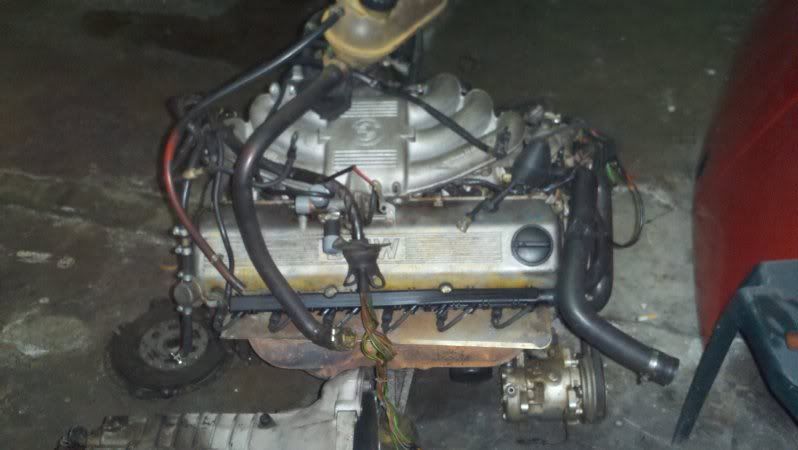

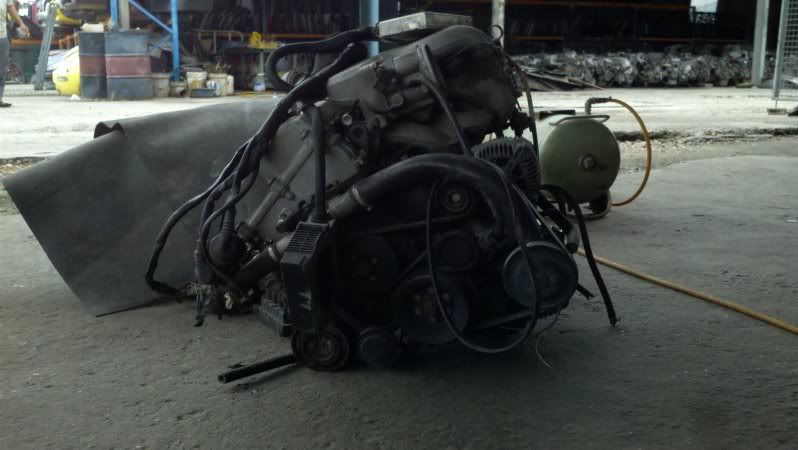

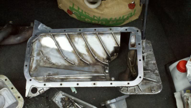

Here are the parts that I have gathered so far, now only waiting for M40 longshaft.

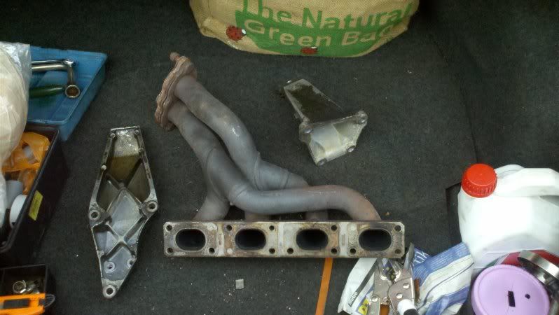

E30 M42 headers and engine mounts sourced from e30zone.net:

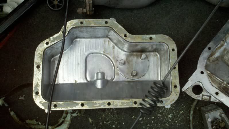

E30 M40 upper and lower oil sump sourced from mudah.my:

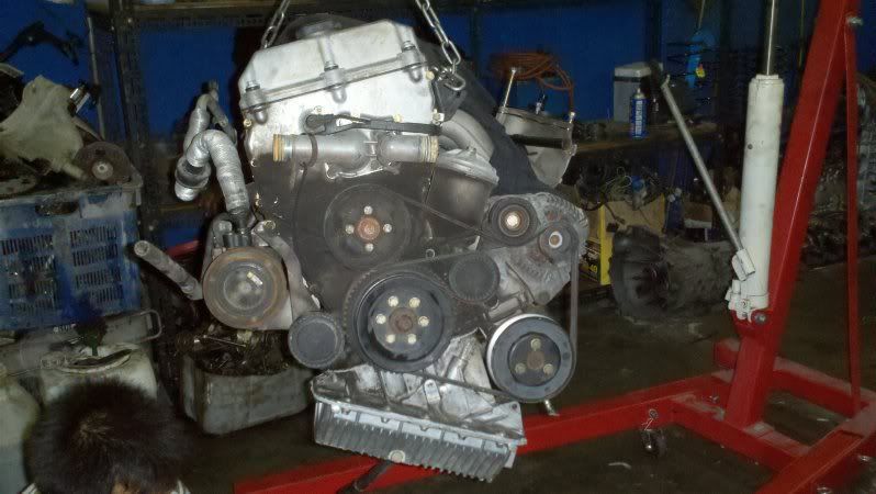

PostPosted: Wed Jan 26, 2011 10:40 am    Post subject: Re: M20B20 to M42B18 swap Reply with quote

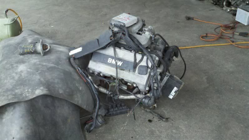

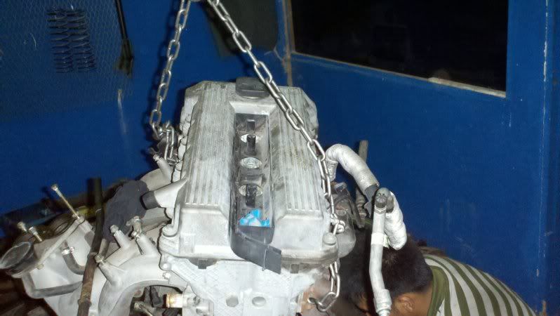

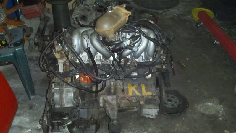

Went engine shopping today Smile officially koyak for the rest of the year hahaha.
and it came with a maroon label dme. some say its rare.
PostPosted: Wed Jan 26, 2011 2:59 pm    Post subject: Re: M20B20 to M42B18 swap Reply with quote
very rare..

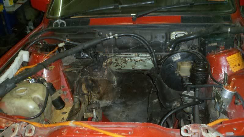

PostPosted: Thu Feb 03, 2011 3:29 am    Post subject: Re: M20B20 to M42B18 swap Reply with quote

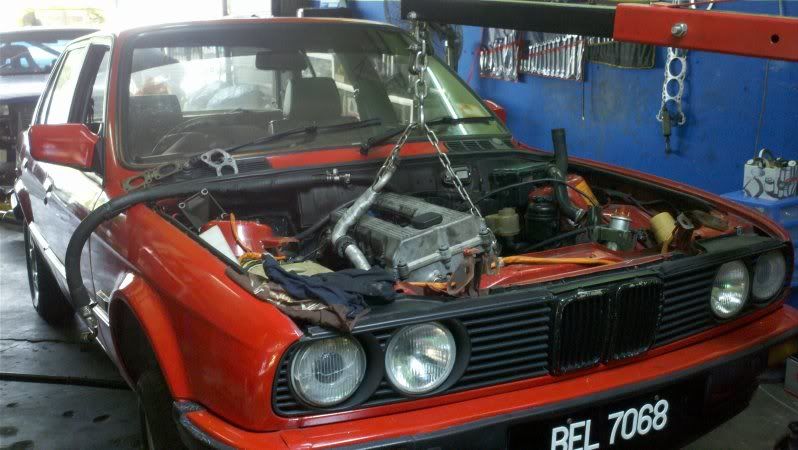

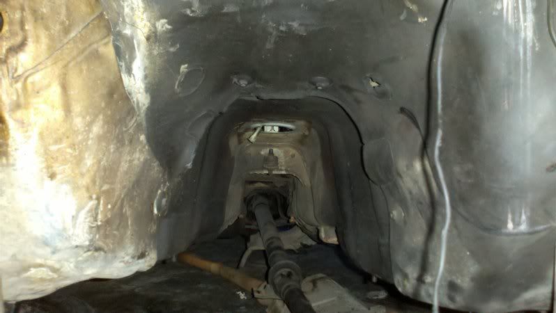

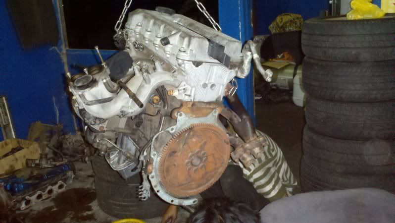

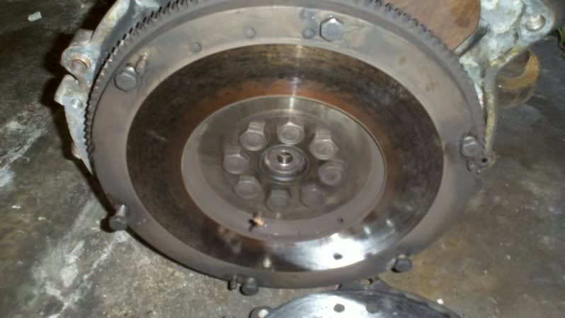

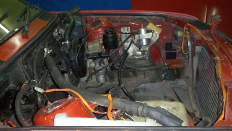

Here's some update, going quite slow cause mechanic tak cukup tangan.

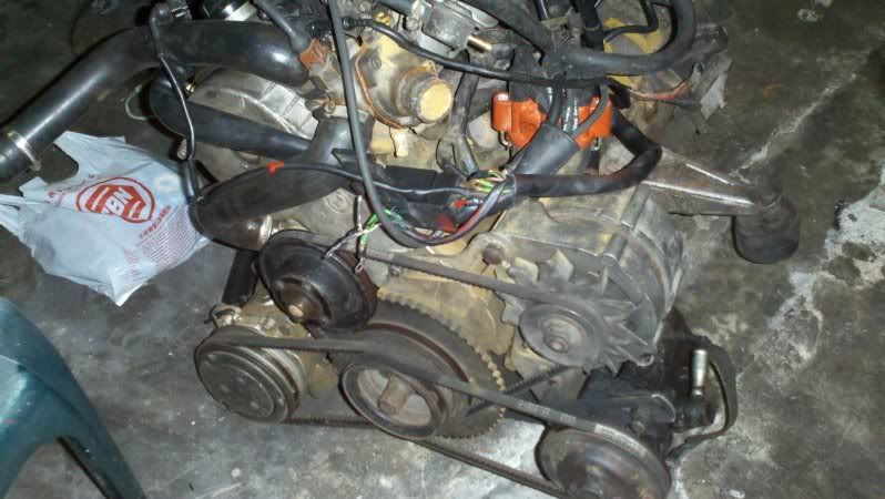

Old engine out, most item up for sale! PM me Smile

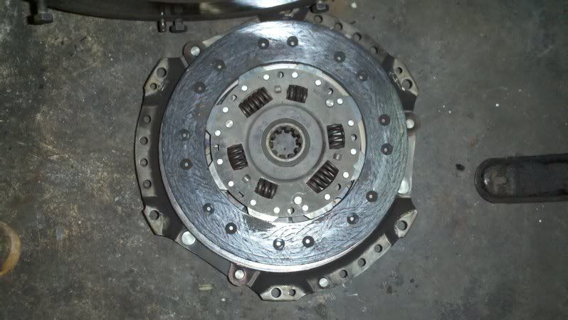

Clutch and flywheel

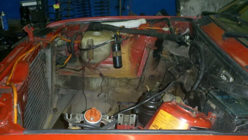

Engine bay

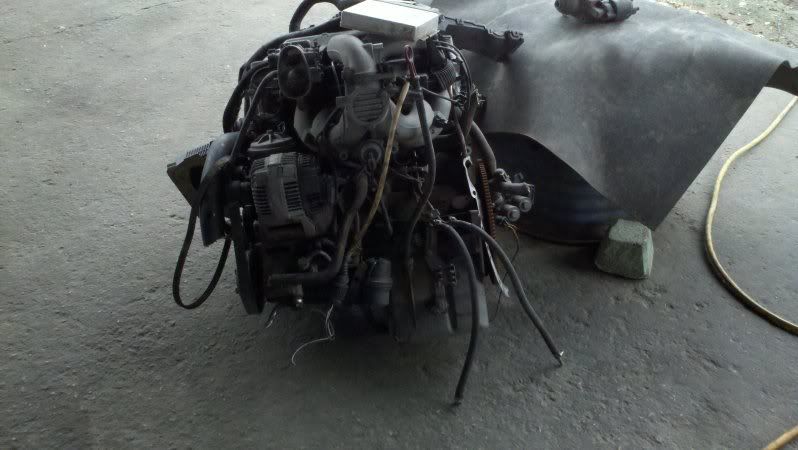

New engine, sort of

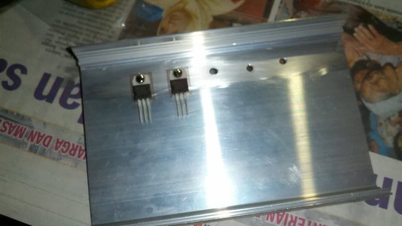

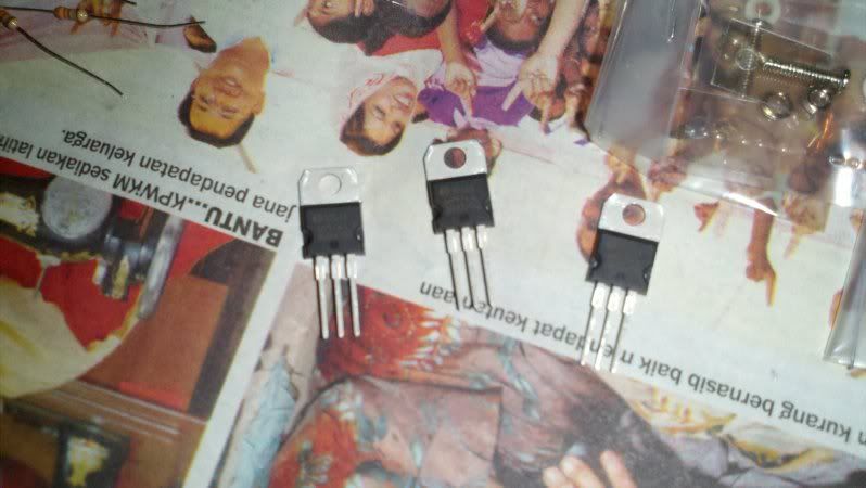

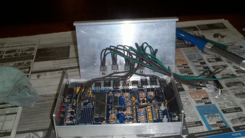

Ordered 5 BIP373 ignition coil driver to fire M42 individual coil. Extra 2 for RB25DET testing.

Bro.. Buat sekalila engine bay tu bagi nampak cantik sikit.dah masuk enjin nanti rugi pulak...
PostPosted: Fri Feb 04, 2011 2:31 am    Post subject: Re: M20B20 to M42B18 swap Reply with quote
Engine bay tu ok lagi, cuma nak kena cuci je.

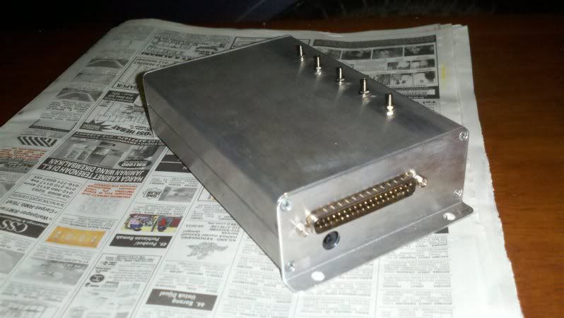

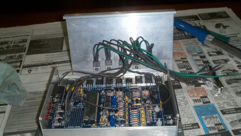

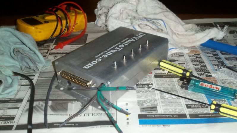

PostPosted: Mon Feb 07, 2011 9:38 am    Post subject: Re: M20B20 to M42B18 swap Reply with quote

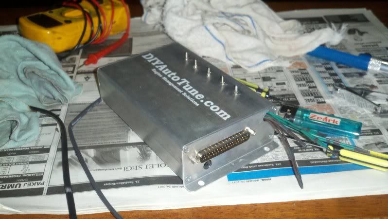

Some pics on completed ignition drivers:

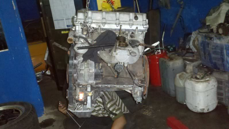

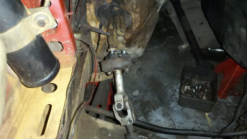

PostPosted: Tue Feb 08, 2011 8:06 am    Post subject: Re: M20B20 to M42B18 swap Reply with quote
Engine and gearbox in but tilted since I'm using m20 gearbox. Should the mech modify engine mounting to suit gearbox or modify gearbox mounting to suit engine?
