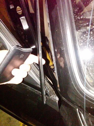

Hi All sifus..may i ask how do i fix this loosen plate around my door frame (other than typical silicon sealant or glue) as shown in this photo?
sometimes it will displace from itz position & flapping while travelling on high speed....luckily it didn't fly off!
many thanks for the advice.

clean the groove and use sealant or automotive goop (can get it at Ace Hardware) do not delay, that item is hard to get.
PostPosted: Tue Nov 24, 2009 3:29 am    Post subject: Re: How do i fix this loosen plate? Reply with quote
then u need to buy moulding clip RM3 each..

The front section uses some metal clips to attach to the frame, use like 4 or 5 there to be safe.
On top, nothing much as it snaps into the frame railing, just that at the end where it meets the next piece, make sure there is the clamping piece there as well.
PostPosted: Mon Nov 30, 2009 2:43 am    Post subject: Re: How do i fix this loosen plate? Reply with quote
tks bro for the detail advice! wil drop by Munich Auto for the clips 1st before i can firm the position of the plate...

i super glued mine after my right side flew off while i was doing 230km/h ! So i super glued the replacement and the other side as well and also super glued the clips too for good measure. They never came off again !!
Oh and i too had to buy the replacement at that time for RM300 +. But nowadays cannot even get replacement even if u have money !
