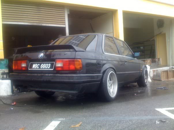

PostPosted: Wed Jan 13, 2010 3:55 am    Post subject: wide body Reply with quote
salam.... nk mntak pndangan ckit...
sy bru jer tukr rim ac lebar 17x8.5 msuk ker e30...
tp rim trkluar ckit dr body....
so elok bwt wide body or ketuk ckit jer body...
pning2....
PostPosted: Wed Jan 13, 2010 4:29 am    Post subject: Re: wide body Reply with quote
adjust chamber to minus Laughing
so maksudnya tayar belakang sekarang dah 235 la ni?

That's the 'price' you have to 'pay' when converting to something that is not a standard specs =). maybe getting a 5 lugs rim is a better idea. Good luck.
PostPosted: Wed Jan 13, 2010 5:28 am    Post subject: Re: wide body Reply with quote
Spacer 5 lugs tu dah tebal dah bro.Kurang² dah berapa cm dah...
nak taknak kena ketukla.. makesure spacer tu kuat utk pegang rim tu.ketuk sikit xpe asalkan puas hati.
kalo nak lagi puas dan xde problem ko convert ke e36ti trailing arm je bro.senang xde nk letak spacer.tp susah sikit nk jumpa trailing arm tu.
pasang betul² trailing arm tu coz takut ada kacau geometri kete ko nanti.
PostPosted: Wed Jan 13, 2010 5:55 am    Post subject: Re: wide body Reply with quote
wait seminit! original offset for E30 is 20-27max. buleh tau brapa offset baru ko tuh? aku rasa mesti offset ko 35 nih:) back spacing brapa? kalo dpt sumer tuh baru ko leh calculate spacer tuh, brapa mm diperlukan...kalo chantek mesti dpt ori offset. kalo takmo pening carik ler tayar 205-40 atau 195-45 ekekkkkee hipari style...
....tgk gamba dibawah salah sebuah kereta malat forummer:) gerenti takda gesel-gesel fender...
happy headache bro! kekekekkekeke...
