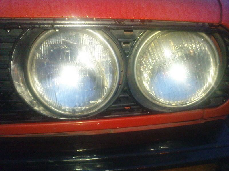

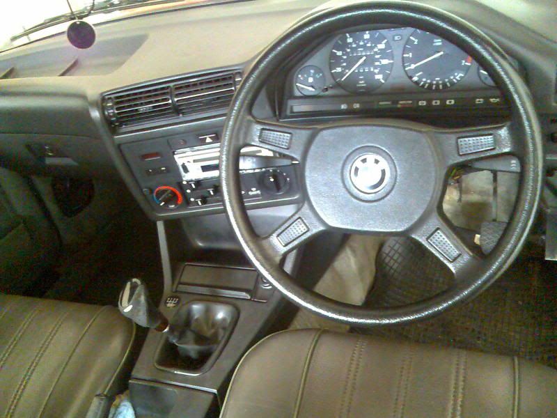

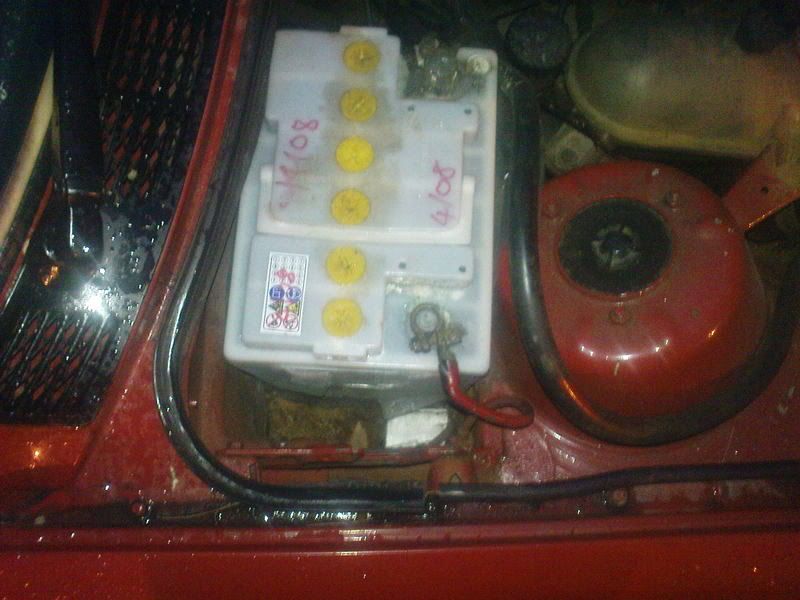

btw does this candidate worth 4.5k? is this m20b20 l-jet or motronic?
PostPosted: Thu Feb 26, 2009 4:44 pm    Post subject: Re: nooooobbbbbbbbieeeeee reporting! Reply with quote
looks like a ljetronic engine to me.
4.5k for an e30 sounds too good .
best is to check the chassis ..
most importantly , check under the carpets...at the floor of the car, passenger/driver side .
under the front wheel wells , from ur photos , the car might have some rust at the battery holder plate.
also if possible jack n look under the car for holes/rust at the undercarriage (all around the car)
dont forget to check near the firewall (area between the engine n cabin of the car)
all prefacelifted e30's are mostly NOT galvanised body, and are more prone to metal rust.
start the engine , it should idle at 700-800rpm when warm without aircon on. idling should be smooth.
most important kasi check the chassis kow kow for a clean car.
if not in the future, banyak kerja to buat/kemas.
goodluck & welcum
PostPosted: Fri Feb 27, 2009 1:09 am    Post subject: Re: nooooobbbbbbbbieeeeee reporting! Reply with quote
tq wks79 :D, i've checked the car once but was at night, spotted rust spot at firewall near battery, behind clutch pedal, and front-driver door. Btw i've opened the hood but dunno where to make it stay up, had to ask my fren to hold the it whilst taking pics lol. mmg super newbie hehehe. Any estimate budget if i'm going to redo the whole car? 4k sufficient ka?
