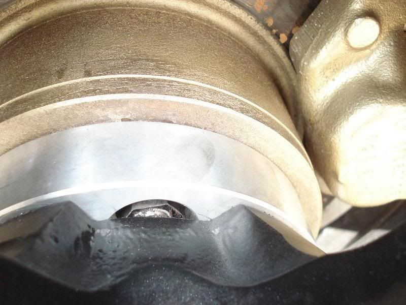

so far i'm also using spacer....nothing bad happen to me so far...but after i saw this pic....takut plak nak merembat...lucky my spacer are hubcentrics...huhu...
this my spacer...
