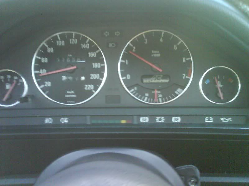

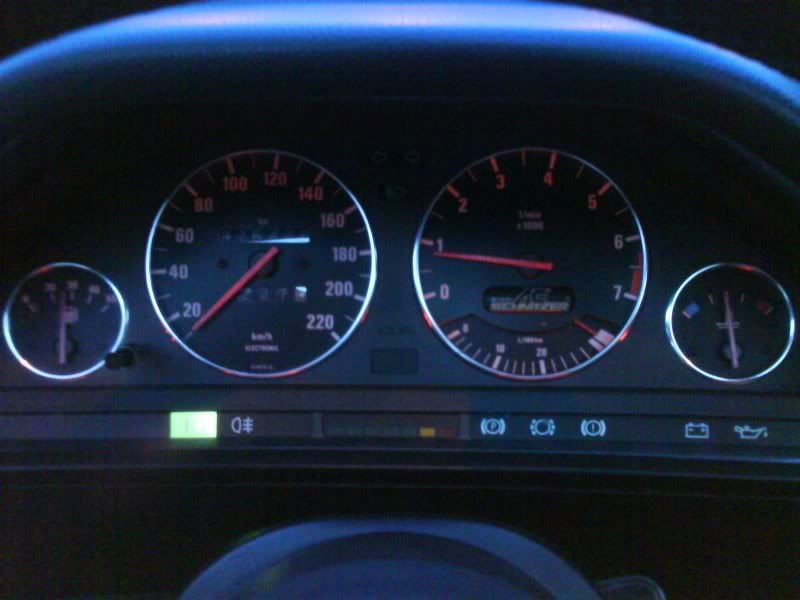

I think I have 'luckily' solved my temperature issue for now...
Yesterday I went to Melaka for a biz day trip early in the morning. As I drove frm USJ passed Seremban, the temperature was ok stationed at half way mark (needle pointed middle)....
However, when I approaching Pedas/Linggi with high speed 140km/h and above, I noticed my temperature gauge started to shot up to 3/4 mark! Shocked So I have to stopped by the R&R to cool down the car a bit...called ah Poh & he said suspected radiator clogged or the head gasket is leaked! Shocked
so after half an hour of cool down, i drove slow slow to maintain low speed at low rpm til I reached Alor Gajah (the temperature won't shot up if i drive in town with low speed 60-80 km/h... Crying or Very sad
so sent it to a nearby workshop recommended by biz client, the mech dismantled my radiator, sent for 'cuci tangki', changed my coolant and radiator gasket.....Huola! Very cool engine and all the way smooth from Melaka back to USJ! Razz
My temperature now is only 1/4 mark or sometime slightly lower than 1/2 mark.... Very Happy
BEFORE :
AFTER :
No need to change the fan & thermostat at the moment i guess????..... Surprised Surprised
