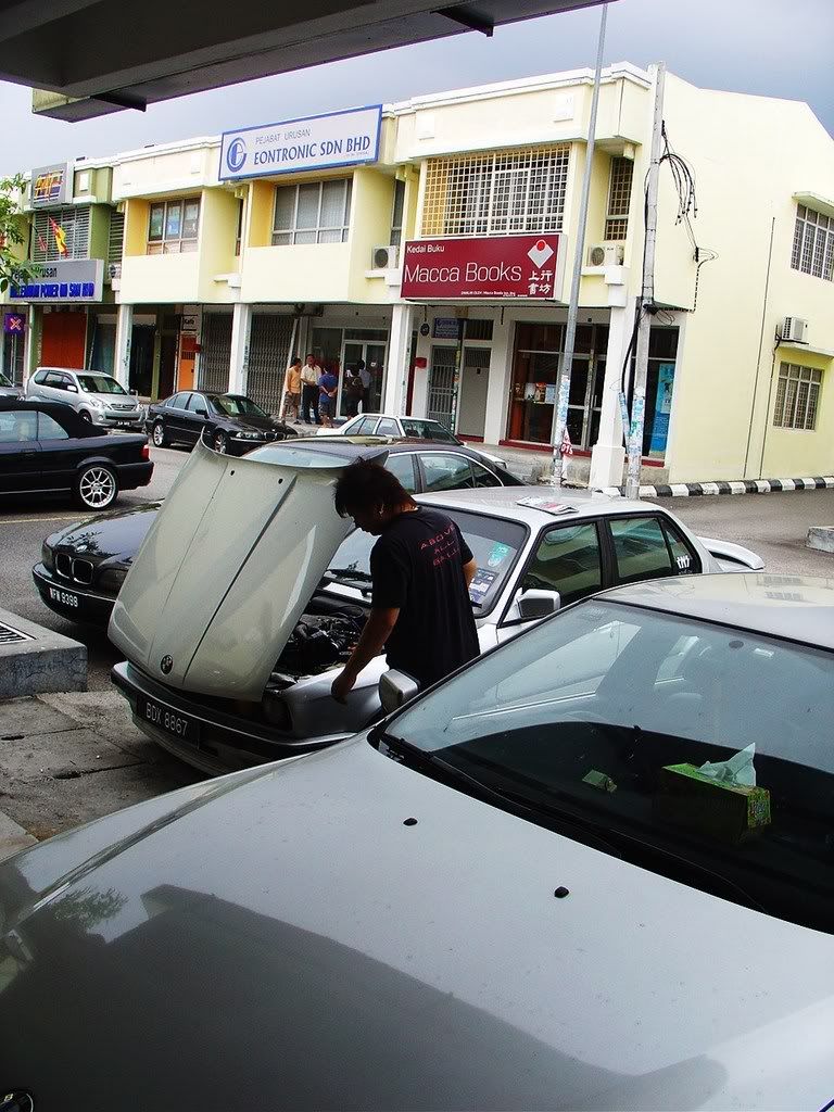

not for long bro, although the car now can rev freely, after hard rev, the car is like having fuel starvation, if i let the car idle, the car wants to die off, if i press the throttle, its like slowly going up and misfires. I suspect is the wires on the switch that are bad or corroded...aiyoh...
PostPosted: Mon Dec 24, 2007 10:16 pm    Post subject: Re: fed up la Reply with quote
damn mechanic, busy talking!! Mad
[img][/img]
Dont care la!!! Do myself!! Confused
why la why always got problem... Crying or Very sad
PostPosted: Tue Dec 25, 2007 4:44 pm    Post subject: Re: fed up la Reply with quote
err.. where's is that la bro? IMHO, u should fix the basic problems first i.e. leaking / harden hose etc. Replace the normal wear & tear. And after that you can slowly diagnose for actual prob.
I saw u holding the AFM. Try to move the 'flap' inside it. If it's a lil' bit hard or not smooth to move, then that's one of ur problem. You can also try to 'de-carb' the engine. Who knows the carbon has clogged in there.
You don't like the shop? Ask me or Highwaystar. We try to help u out. Good luck =)
