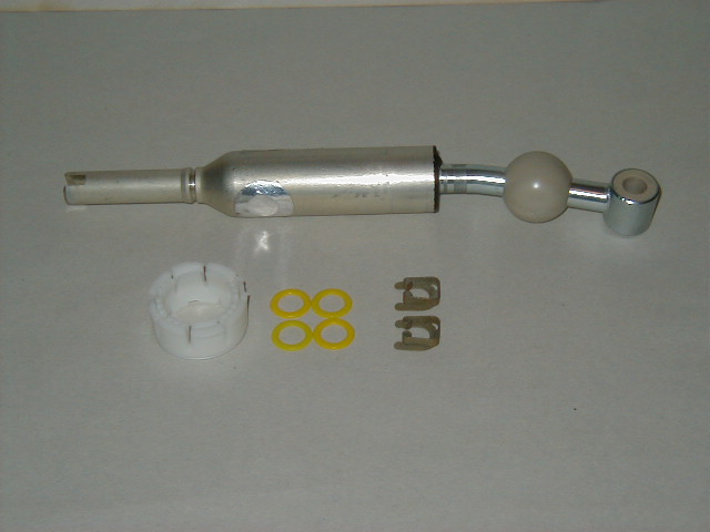

anybody have a picture of short shif....

I'm using the ssk similar to the pic from calvin's eurocarmotorsport he said it was from the z3m. Got it from him at RM220 many years ago. Very notchy and short throws. you've got to be quite accurate in you leg work and your shift work to get it to work right. otherwise its quite a hassle. The age of most e30 gearboxes don't help the situation. My advise, go for the z4 as the throw is longer and not so notchy but its easier to engage the gears and that makes a big deal in a kl jam. Better still try a car which has a ssk and see if its really what you want.
